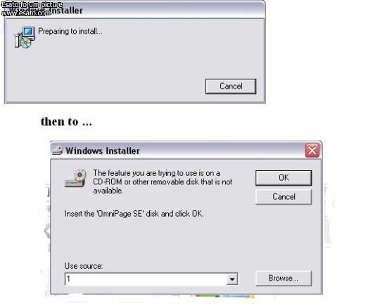

if i go into my documents and right click on a picture or folder etc
this comes up
i then click cancel , cancel etc and it eventually comes up with the menu to copy cut etc
how can i stop this, i dn't have the disc to install the program and i've removed the program from the program list
HELP its soo annoying [addsig]

Sounds like you've got a 'extra context menu' that's linked to program that doesn't exist on your PC at the minute...
Two ways to hit this one:
1. Have you got a scanner? If so, the disk it's asking for might be your scanner driver CD. Try putting that in, and if it still doesn't work, put the disk in normally and see if there's a progrm called 'omnipage' on it. It's an optical character recognition app for scanners that is often bundled with the scanner itself. Install it, then uninstall it from add/remove programs if you don't want it on there. If you can't can't find the omniscan prog, then...
2. Download this program, 'hijack this' - http://www.download.com/HijackThis/3000-8022_4-10227353.html
Run it, click 'ok' on the warnings, and select 'run a system scan and create log report'
Copy and paste the log report here (it's a text file), and we can take it from there
