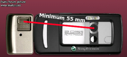

MarkJason
u r using mxe-60? because they say the distance between the flash and the camera lens should be at least 55 mm in order to avoid red eyes. K750 with MXE-60 manages this fine, about 80mm. well k750=w810 same case the design of this lens in the same distance
Each environment each condition is assigned a response to the sensor environments conducive to use the flash mxe-60 figures of exposure and iso are other has to adjust the values and testing them in environments suitable to the time of exposure and are iso other values
Say for the K750 or W810 and MXE-60 happens to be mobile phone and it's accessory and not proper digicam, we never will get technical specifications about flash duration time and such self-evident facts but i trust you guys.
The flash shoot also with the environment and we must also synchronize the time of the sensor led the camera with the flash mxe-60 then for each environment and conditions features and conditions for the reflection of light is very important and each depends on the hardware and firmware will behave
[Non-flash photo: 1/20s, ISO 500, flash photo 1/15s, Iso 200 and exposure correction] maybe
I donīt know if these features r exactly ,have to test

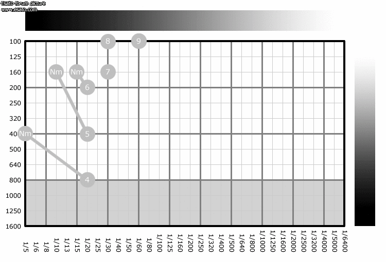

"bought my MXE-60 last summer while the firmware version R1L002 was the latest. That version could deliver both ExposureTime and ShutterSpeedValue on Exif data. 1/15sec and 1/16sec were the values. (Later firmware versions have dropped that ShutterSpeedValue) But the exposure time of the flash itself is much shorter, as the demonstrative test photos of my waving hand and rotating record players show clearly."
"Verdict: the camera does 1/15s but MXE-60 Xenon flash does it much much shorter...."
"You noticed something essential in low light photography. As you might know, these simple cameras can adjust the correct exposure only by exposure time and sensor sensitivity (film speed) because the aperture is fixed (2.8 on K750)."
"In normal mode the longest exposure time on K750 is 1/20s, in Night mode 1/5s. The highest ISO sensitivity is 800 (after latest firmware)."
"Photographers call lightning situations for Exposure Values, combination of the three above. K750 starts using it's longest exposure time at EV 6, while EV 4 is the darkest, where K750 still manage to deliver correct exposure. At EV 6 the sensitivity is 200, at EV 4 the max 800."
"Here some descriptions of such EV situations:
EV 4: Candle lit close-ups. Christmas lights, floodlit buildings, fountains, and monuments. Subjects under bright street lamps.
EV 5: Night home interiors, average light. School or church auditoriums. Subjects lit by campfires or bonfires.
EV 6: Brightly lit home interiors at night. Fairs, amusement parks.
The moment you want to add more exposure compensation, the only way K750 can obey is by increasing ISO beyound the normal 800 limit, up to 1600. With the MXE-60 mounted on, the output power of the flash is regulated instead.
It's worth opting for Night mode, but then the longer exposure time becomes a problem. Take a look at these examples of noise level in Normal mode vs Night mode, ranging from EV 4 to EV 7"
