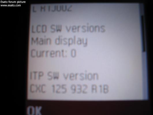

my friend got a K750i as gift when he tried to use the camera the camera dont work instead it jump back to the main menu again...
i tried to check his firmware and found this....
thought there a line call camera SW version something like this??
any users can help?

Quite right mate, there should be three lines with "Camera SW versions / Camera / Current: X.X"
I'm wondering if the camera cable has worked loose on your phone like it has on some other K750i's.... There's some thread with pictures regarding re-seating the camera cable... See if you can find it - I'll search around too and reply with a link if I locate it...
