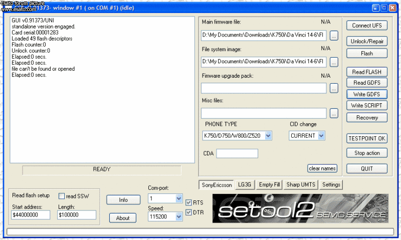

@leprechaun - Thanks for the link. Here's a screenshot of my SEtool2. Can you tell me where I enter the code that mb-new is talking about in this thread.
Is this the wrong program to use? I've also head of Cruiser, but wanted your thoughts before I went for it.
