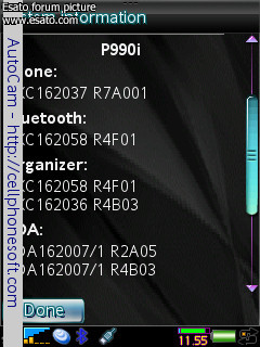

Yes i did have 2 cda lines. At first the first line shows my old cda (cds/5) and the second line shows the new one (cda/1). Fortunately seus detects the new cda. And after updating with SEUS it still has two cda lines. But this time both lines shows cda/1. Here's my screen capture after SEUS update.
[ This Message was edited by: spectre77 on 2007-02-18 04:02 ] |

If you have 2 CDA strngs then the FW flash and CDA change is not being completed properly and this can lead to future problems. It should be completed by the client to change the string you have, and not have a second set of FW.
There should be an option in the client to solve this issue?

Strange - I did have 2 cda lines after changing them. But since a master reset and the upgrade I have only one cda. Sounds like something went wrong with you cda change or upgrade.
