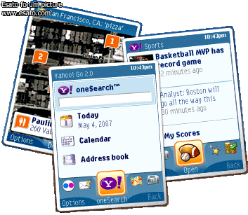

Maybe is not a what you want, but try "Yahoo!Go 2.0" java app. Works perfect on K800 and other SE phones.
This java app included:
Yahoo mail (for me as gmail client useless)
One Search (fine)
Maps and navigation (very close to Google maps)
Flickr upload and browsing (Perfect)
RSS reader
Weather
etc. (Calendar, contacts)
Its free and is a must have app for you
Download and info here:
http://mobile.yahoo.com/go/tour
I hope that google release soon this kind of application (all in 1) for cell phones.
