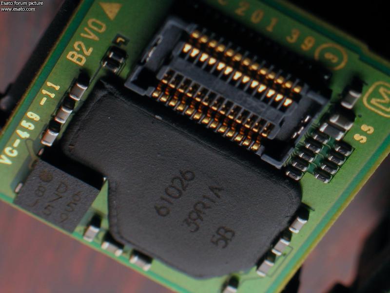

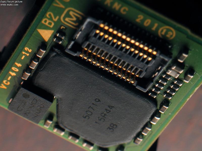

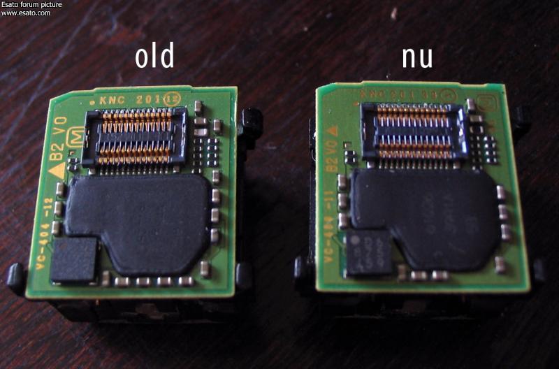

Here are picture one guy sent me who did it:
OLD cam - CID36
NEW cam - CID49
See also http://www.esato.com/board/viewtopic.php?topic=135737&start=4305 (middle of the page...)

Posted: 2007-07-05 15:06
in the pictures we can easily see that the CID49 cam misses a lot of "chips". could this be the reason of the poor quality of the photos?

Posted: 2007-07-05 15:17
holy moly - why have I not recognized this ... seem I work too long/much??
THX - Thatīs it...
THERE IS A SIGNIFICANT DIFFERENCE ... not only in quality.
