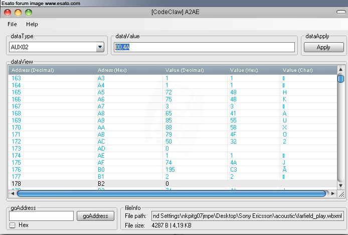

Codeclaw A2 Acoustic Editor, Modify your own WBXML Acoustic
by Thunderbird and Jockep
Now it's complete and it should work, this program allows you to create your own wbxml acoustics. It has one Basic Mode and a Advanced Mode that looks a bit like winhex. I hope we will see alot of new acoustics after this!
Requirements:
.NET Framework 2.0
Download:
http://codeclaw.iouri.net/index.html

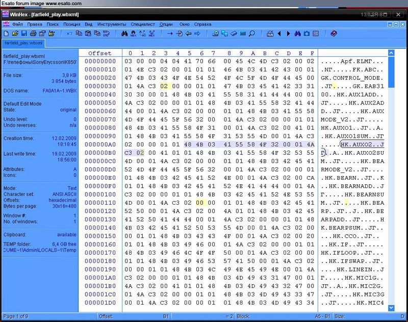

The example I gave for editing audio for firewood A2 (on the other platforms just as well). To edit the drivers we need:
Program WinHEX
Sound driver
Well, actually, and patience
So dispel our sound! As usual we start a program WinHEX, open the folder with our drivers that we will edit! . Then simply drag this any driver (which you can edit). List of drivers (which is responsible for what):
Files starting with "farfield" refer to the speaker:
farfield_call - driver loudspeaker during a call
farfield_fm - driver speaker in FM receiver
farfield_play - driver loudspeaker mode proigryvatelya/mp3
farfield_ring - driver loudspeaker mode calling signal
farfield_rec - driver and microphone for video recording on a dictaphone.
Files starting with "PHF_" refer to the headset (headphones):
PHF_play, PHF_2_play, PHF_3_play, PHF_4_play - when listening to music / sounds
PHF_call, PHF_2_call, PHF_3_call, PHF_4_call - when you talk
PHF_ring, PHF_2_ring, PHF_3_ring, PHF_4_ring - when an incoming call (if enabled "Silent"
BTL_play - while listening to the player through BT headset
handset_0_call - the sound of conversational dynamics
Sysconn_fm - radio in the headphones

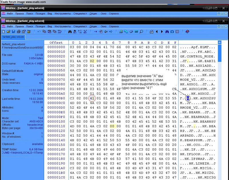

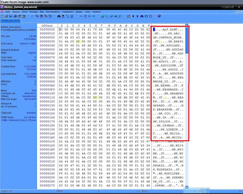

Sway any of these profiles in the program WinHEX (in my example, I peretyanul profile farfield_play)
You will see that the program will give you a bunch of all values! Do not worry ...
The right hand column you see any names, letters, symbols, etc.
In the middle column you will see a big pile of all the numbers.
In the left column, we do not want;)
We start editing from the right column (where there is a letter)
There you will see such options as:
HK.AUX01 .. JG - and HK.AUX02 .. JG - this volume
HK.SPKRN .. JG - responsible for the loudness of the sound and bass
HK.SPKRP .. JG - suppresses all the distortion, rattle, etc.
GK.NoiseReduction - this parameter is responsible for noise suppression
GK.DRS .. HK.RX.. IG - Dynamic range (a kind of equalizer for frequency)
HK.RXFILTER - the sound quality in general (sound, filtering)
And not only these parameters, in addition to these there is still much any, but basically we have enough and to edit these settings and get good sound.

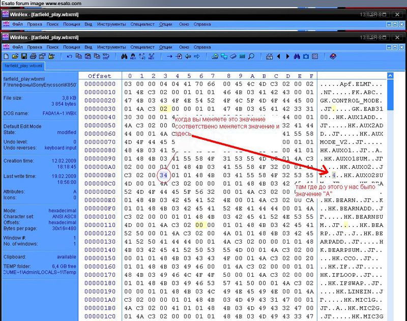

On the screen you see, I started to edit a parameter HK.AUX02 .. JG (I took it for example)
Near it you can see is that the (letter) "A" through two points
In order to increase the value of the parameter (in addition to the volume or noise, frequency, etc.), we need to reduce the value that is 99 .., 10, 09, 08, 07, 06, 05, 04, 03, 02 , 01, 00, FF, FE, FD, FC, FB, FA, F9, F8, F7 ... since F is - E then D, I and C, B, A.
In order to reduce the volume needed to increase the value (only in reverse order)
So we are doing here:
You see that was before "41", as I lowered to 34 - that is, the value I have fallen, and the sound will be louder. Keeping our profile, pour it into the phone - happy.
. Actually that's all ... just very, you can edit other settings (for example HK.AUX01 .. JG, HK.SPKRN .. JG, HK.SPKRP .. JG, etc.) I hope I explained everything clearly, good luck you are editing:) A bit taken with manual

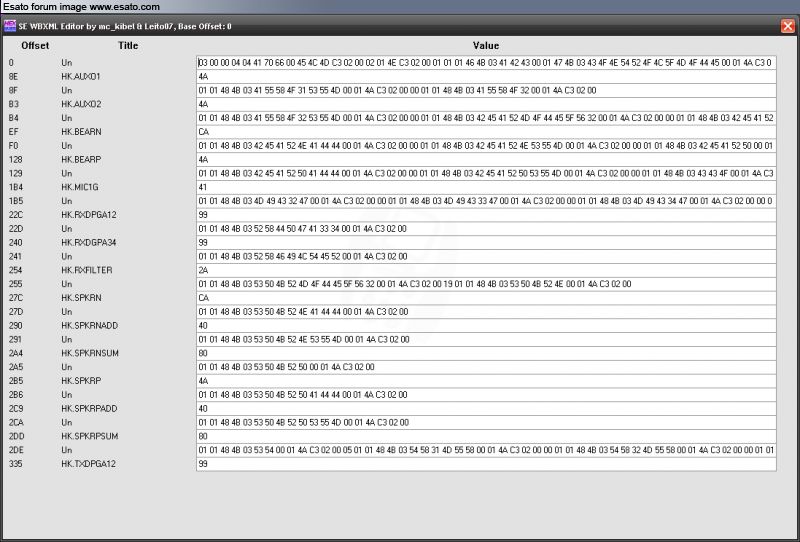

Idea by Leito07 - he gave me offsets and informations about WBXML. I wrote a WBXML Template for WinHex (it is first beta-version, we don't know all values, it will be updated as soon, as possible).
Copy the text from codebox, paste it to the notepad and save as wbxml with tpl extension:
Code:
template "SE WBXML Editor by mc_kibel & Leito07"
description "SE A2 .wbxml Editor by mc_kibel & Leito07"
begin
hex 0x8E "Un"
hex 0x01 "HK.AUXO1"
hex 0x24 "Un"
hex 0x01 "HK.AUXO2"
hex 0x3B "Un"
hex 0x01 "HK.BEARN"
hex 0x38 "Un"
hex 0x01 "HK.BEARP"
hex 0x8B "Un"
hex 0x01 "HK.MIC1G"
hex 0x77 "Un"
hex 0x01 "HK.RXDPGA12"
hex 0x13 "Un"
hex 0x01 "HK.RXDGPA34"
hex 0x13 "Un"
hex 0x01 "HK.RXFILTER"
hex 0x27 "Un"
hex 0x01 "HK.SPKRN"
hex 0x13 "Un"
hex 0x01 "HK.SPKRNADD"
hex 0x13 "Un"
hex 0x01 "HK.SPKRNSUM"
hex 0x10 "Un"
hex 0x01 "HK.SPKRP"
hex 0x13 "Un"
hex 0x01 "HK.SPKRPADD"
hex 0x13 "Un"
hex 0x01 "HK.SPKRPSUM"
hex 0x57 "Un"
hex 0x01 "HK.TXDPGA12"
end
[/code]
Move this file to the WinHex folder.
Run WinHex, open WBXML file. Press ALT + F12 and select SE WBXML Editor by mc_kibel & Leito07.
So.. lets go modify
HK.AUX - sound "capacity" - lower value = quieter sound
HK.SPKRN - "general" volume - lower value = quieter sound
HK.SPKRP - distortion filter - lower value = less distortion
HK.RXFILTER - sound quality - lower value = better quality
HK.RXDPGA - bass - lower value = more bass
HK.TXDPGA - treble - lower value = more treble
